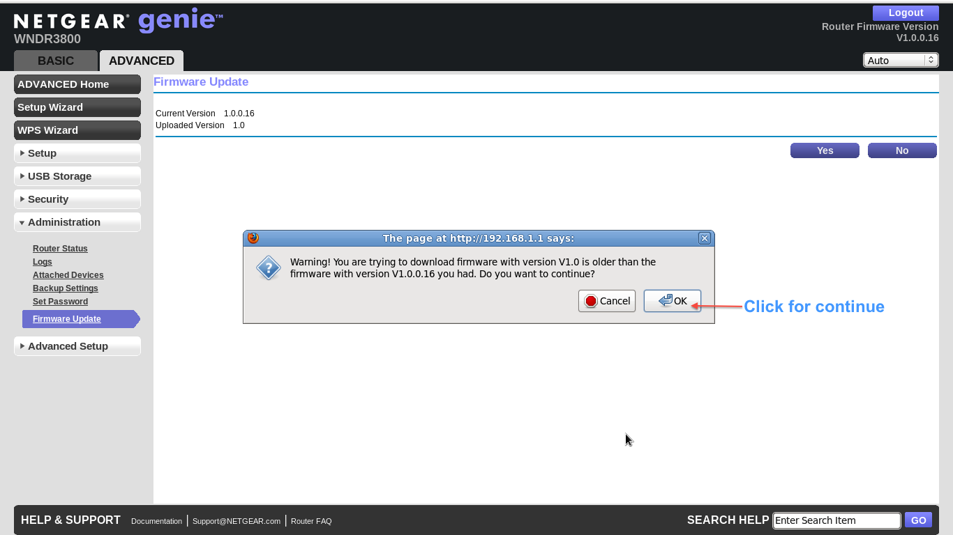

Now it may show a warning if the image (to be upgraded) has a lower version than the existing original firmware (as depicted by the following snapshot). Ignore this warning and click on OK button.(fig: 4).
fig. 4

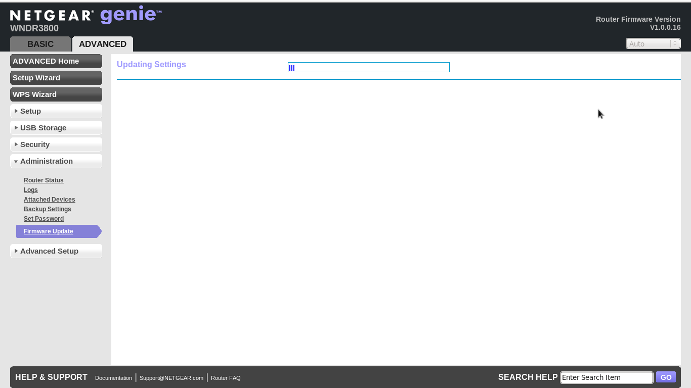

Now the router should start uploading the target firmware. Wait until the image is flashed. You should be able to see the following pages successively.(fig: 6 & fig: 7).
fig.6
fig. 7

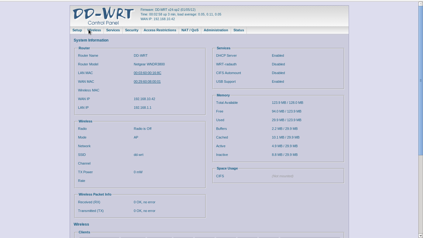

DDWRT:-
fig. 9
