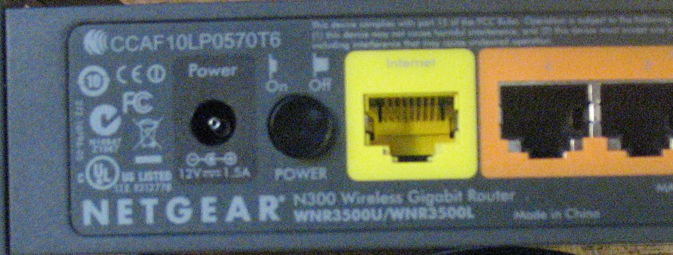

dolo724 said: I have the Sam Knows supplied wnr3500u/wnr3500l, apparently v1, although it has the n300 label next to the model # as in the second picture. Do you know, does this have special firmware for their program or can I use Tomato or something similar? Current firmware version is V1.2.2.26_33.0.28SK Thanks!

Subhra said: Good to know that you are able to recognise your router. Hope, the following two pictures will provide more information to the newbee, WNR3500L :- WNR3500Lv2 :-

My WNR3500L router is exactly as shown in picture posted by dolo724.
It has label N300 WNR3500U/WNR3500L
according to netgear support site, it is WNR3500L v1, but the last post above by dolo724 says it is a v2?

Can you please post some picture of your router so that I can have clear idea about the model ??
Here's a poor-quality photo:
Merely viewing this picture I guess it is wnr3500Lv1. Can you please give a snapshot of your router's boot-log ??

Success! Turns out I have WNR3500L/U/v2, so I used Tomato v. 1.28. The process was easy and is well documented on this site. Thanks to all.
